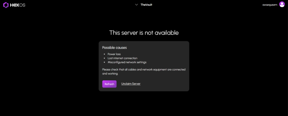

Deck will not connect to hexOS
The deck shows my hexOS server as unavailable and won't connect. I can see the server is online, shares are up and running, and I can log into the trueNAS web ui directly.
I did have tailscale on at first, but I have turned that off and tried everything short of restarting hexOS.

I've been getting the occasional "server unavailable" for a long time. Probably a lot more often than I realize, since I use the HexOS interface so rarely. Whatever functionality is there to detect a lost connection and reconnect, seems to be rather lacking. With no ability to restart just the HexOS layer, the only solution I've found is to restart the whole server. That has always fixed it so far.
Right now I am getting the same thing but it is weird and may not be the same as others.  I only reboot or shutdown the server when I have to. And that is once or twice a week (mostly just once) because of the server unavailable error.  The thing I think is weird is only the wb UI is having a connection issue.  My HD Homerun capture card stays connected and all my TV's still can either watch live TV but also movies and pre-recorded shows from the HexOS server.  My windows drive assignments also maintain their connection to the server.  I haven't tried the TrueNAS connection because honestly, I don't think of it fast enough.  Is it possible something is happening at the developers end that only the web UI seems affected for me?  It is an extremely annoying issue since it requires me to reboot the HexOS server.  When I do I can connect again without noticeable issue.

As far as I am aware, that's pretty much what it is. The HexOS UI does not run on your server, it runs on theirs (Eshtek). HexOS is apparently bad at keeping this connection alive/reconnecting when it goes down. So the TrueNAS interface will work fine, since you access it locally, as will every other service you're running on your server. You just lose access to the one thing you paid for, the HexOS interface. 😛
