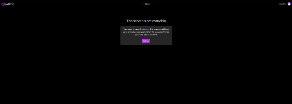

Deck will not connect to hexOS
The deck shows my hexOS server as unavailable and won't connect. I can see the server is online, shares are up and running, and I can log into the trueNAS web ui directly.
I did have tailscale on at first, but I have turned that off and tried everything short of restarting hexOS.

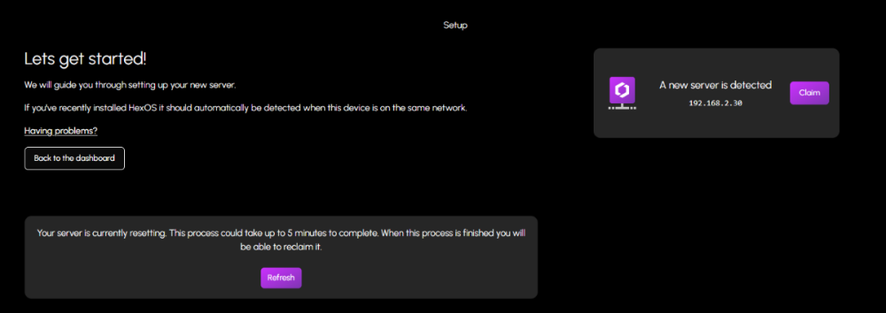

I had the same issue and just choose to reinstall the system in its entirety, however hexos now thinks i am going to add a second server:
@Mobius How can i resolve this?
when you login to deck before you try to claim your server you see this screen
just hit unclaim server
4 minutes ago, Insanittyx said:
Same result, except for 'A new server is detected'
other users have reported deck being a little weird right now because of caching
can you try checking it out with a different browser?
When I click 'Add Server I get the 'Lets get started!' screen.

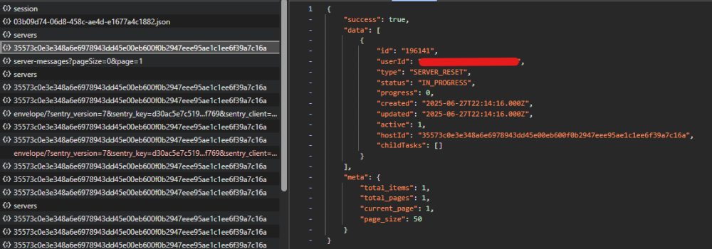

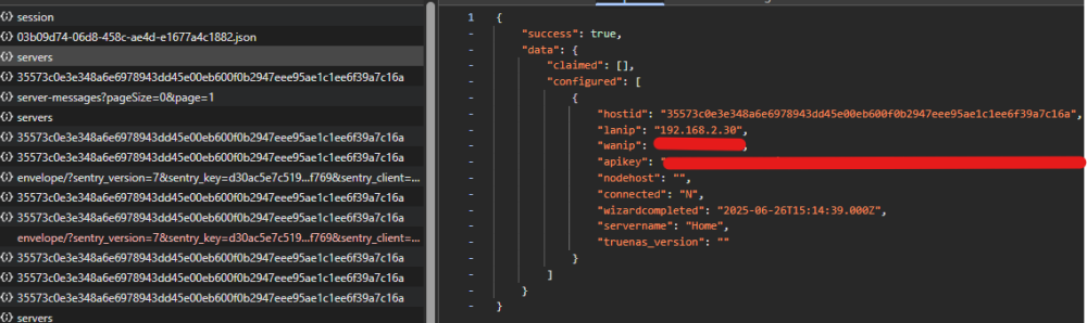

The 'resetting' state comes from the server:

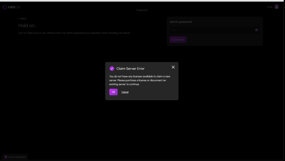

I was troubleshooting and selected disconnect server, with the intent to reconnect. I just get this no license for new server every time. Its the same server, with the same name, same ip, no vpn use here, and nothing was changed other choosing disconnect. how do I fix this?
