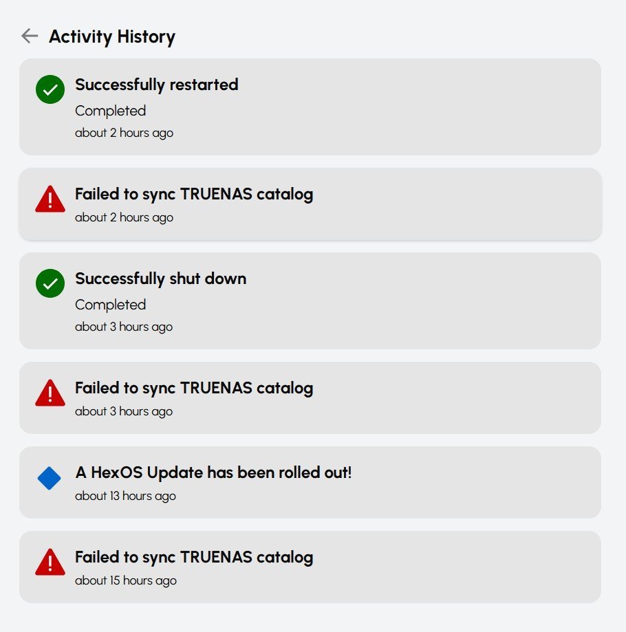

Sonic Posted June 28 Posted June 28 Since the Q2 update I see this message in the activity history of one of my two HexOs servers. The message is: Failed to sync TRUENAS catalog. When I look in TrueNas, I don't see this message. The other server don't show this message. The only difference between the two servers I can think of is that on the server with the warning message i did the update to ElectricEel-24.10.2.2 manualy. For the other server I used the HexOs server to update.

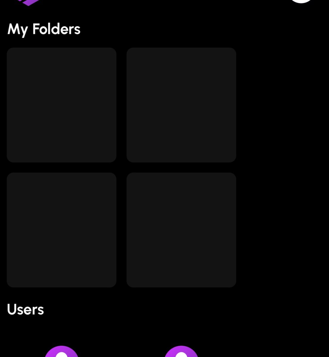

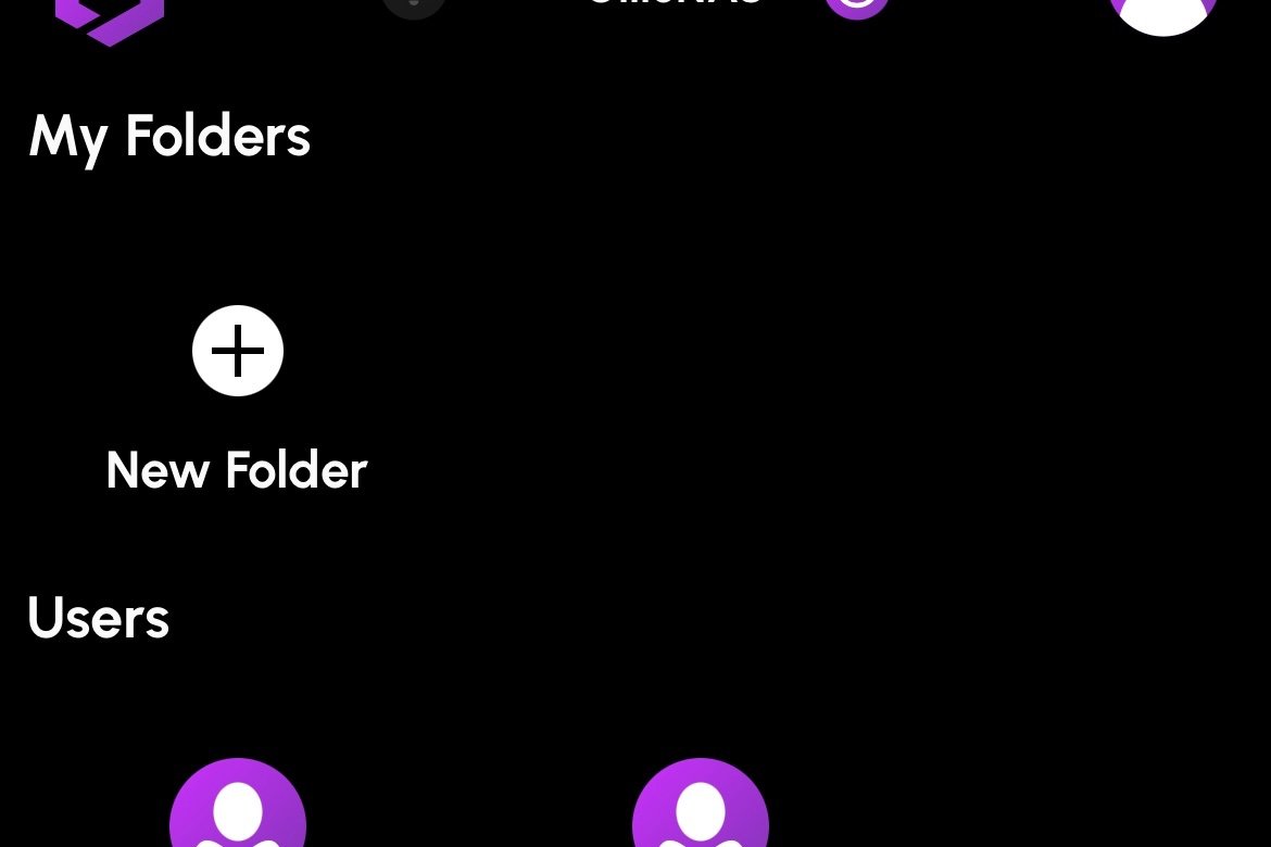

Jakor Posted June 28 Posted June 28 Looks like I do have a minor bug to report after all! My folders don’t seem to load anymore in the HexOS dash. They get stuck like shown below. Tried restarting the server and using a different browser. Hopefully the hot fixes address this, but is anyone else having this problem?

PsychoWards Posted June 28 Posted June 28 58 minutes ago, Jakor said: but is anyone else having this problem? It takes a long time to load (10-15s) but it's showing everything eventually. How long did you wait so far?

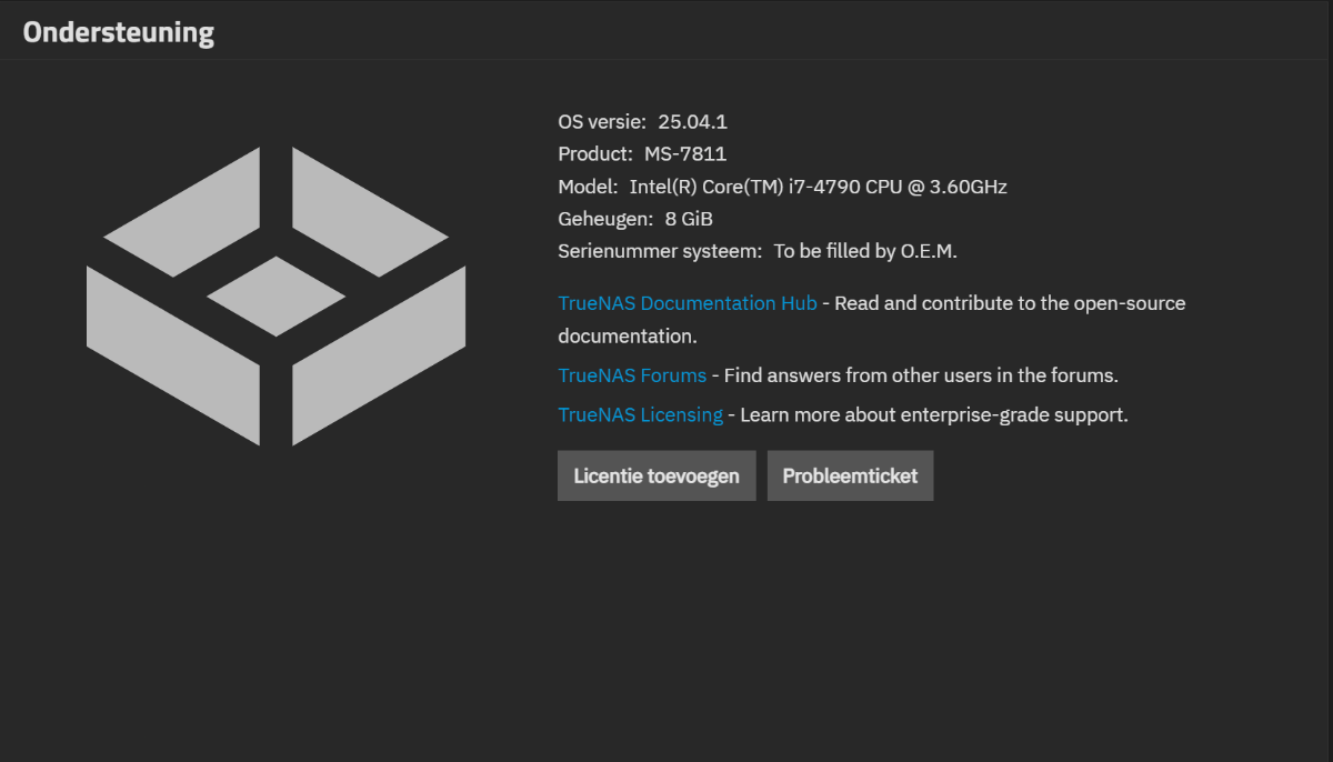

BeardBoss96 Posted June 28 Posted June 28 im on truenas version 25. and hexos update says its 24.10.2 so i think i did somthing wrong ? some one knows how to change it witouth losing my apps en stuff ? i updatet a few days ago on truenas itself so i dont know if that whas wrong for hexos now ?

Jakor Posted June 29 Posted June 29 18 hours ago, PsychoWards said: It takes a long time to load (10-15s) but it's showing everything eventually. How long did you wait so far? Thanks for confirming it works for you, albeit slowly! I waited about 5 minutes. Every 60s or so, the pulsing loading icon goes away and the “new folder” icon appears, but without any of my folders. Then the lasting icon appears again. The page does this behavior in a loop as far as I can tell. fingers crossed there is an easy fix but if anyone thinks they can help fix this, please let me know what additional information would be helpful in troubleshooting!

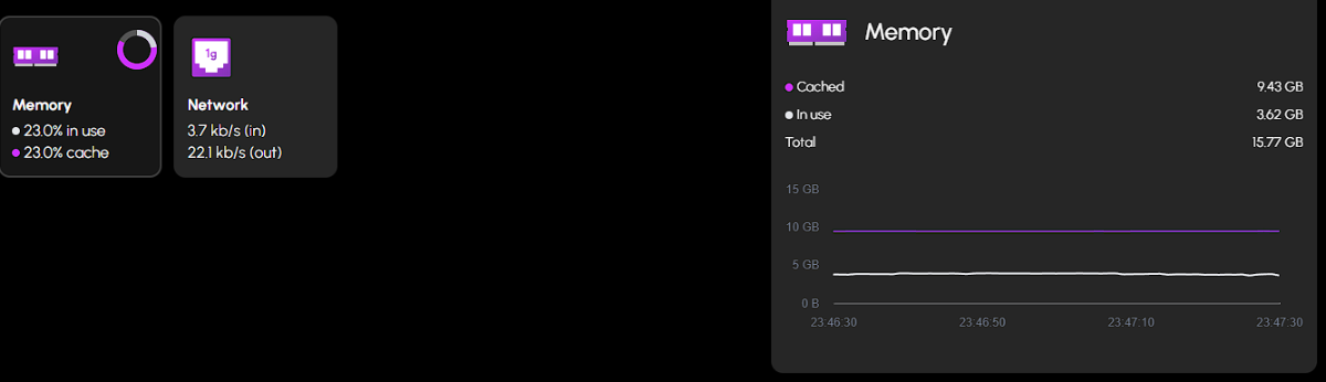

KGeetings Posted June 30 Posted June 30 (edited) I seem to have an issue where the Memory is showing the "in use" percent for the cached memory. I've seen both of them "update" to a new percentage, so I know that it's at least not entirely stopped reporting info. Using TrueNAS ElectricEel-24.10.2.2, and Firefox for the browser to the deck. Edited June 30 by KGeetings

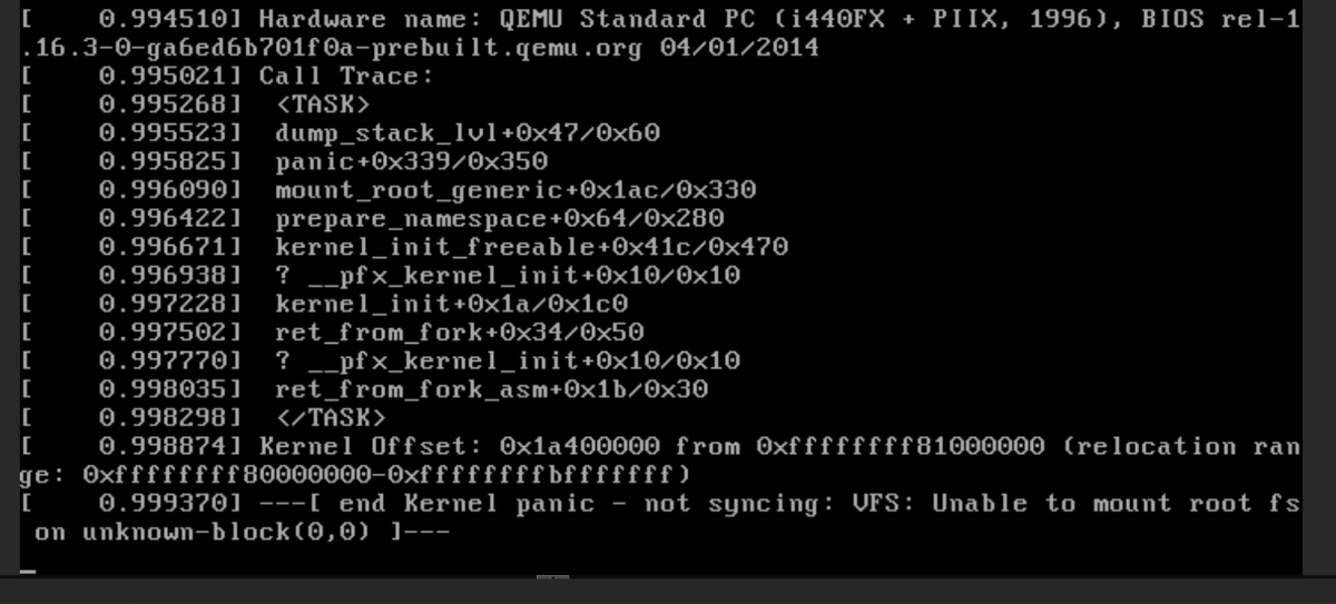

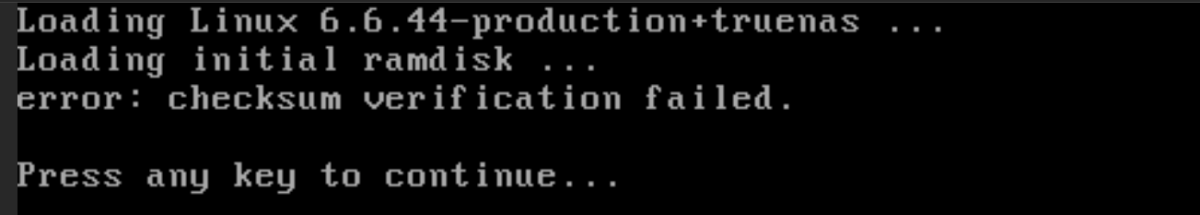

DiaRye Posted July 1 Posted July 1 4 hours ago, rykott said: Yes the 7) open linux shell is where you type it... but only if the boot partition is degraded. You can check that in the TrueNAS gui under -> System -> Boot -> Boot Pool Status. The command is only needed if that is degraded. Once you run it it will look like nothing happened but the pool should be now Online - No Errors instead of degraded, Thanks a lot. This was not my problem apparently. I had a failed install and when I tried again i got the same screen the other guy had. At the boot menu I could delete the previous attempts and try again. Now I am at the right version. Thanks a lot
Prof_gLX Posted July 1 Posted July 1 7 hours ago, rykott said: Yes the 7) open linux shell is where you type it... but only if the boot partition is degraded. You can check that in the TrueNAS gui under -> System -> Boot -> Boot Pool Status. The command is only needed if that is degraded. Once you run it it will look like nothing happened but the pool should be now Online - No Errors instead of degraded, Thank you, it fixed it for me. For reference, I cleared the boot pool error in older version, deleted the bad install, booted in older version, re-did the update and it worked.
mill3000 Posted July 1 Posted July 1 On 6/30/2025 at 5:16 PM, KGeetings said: I seem to have an issue where the Memory is showing the "in use" percent for the cached memory. I've seen both of them "update" to a new percentage, so I know that it's at least not entirely stopped reporting info. Using TrueNAS ElectricEel-24.10.2.2, and Firefox for the browser to the deck. Thanks for letting us know. I verified it was an issue and passed it forward to be looked into. 1

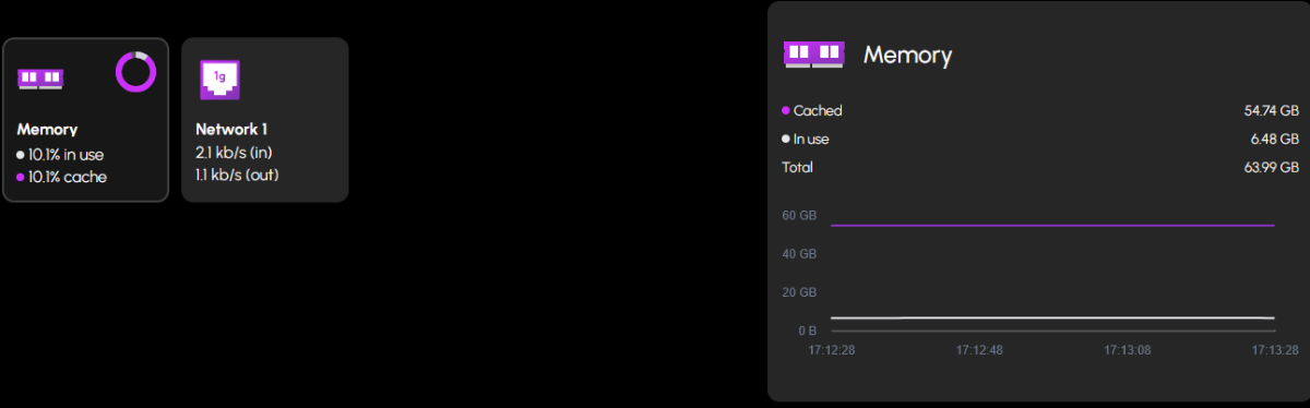

Todd Miller Posted July 2 Posted July 2 On 6/30/2025 at 6:16 PM, KGeetings said: I seem to have an issue where the Memory is showing the "in use" percent for the cached memory. I've seen both of them "update" to a new percentage, so I know that it's at least not entirely stopped reporting info. Using TrueNAS ElectricEel-24.10.2.2, and Firefox for the browser to the deck. Me too. Anyone have any ideas if this is a bug?
mill3000 Posted July 2 Posted July 2 12 hours ago, Todd Miller said: Me too. Anyone have any ideas if this is a bug? Hello. Yes this looks like a bug. We've submitted it. Thanks for taking the time to post the issue!
Elio Posted July 3 Posted July 3 On 6/29/2025 at 7:17 AM, Jakor said: Thanks for confirming it works for you, albeit slowly! I waited about 5 minutes. Every 60s or so, the pulsing loading icon goes away and the “new folder” icon appears, but without any of my folders. Then the lasting icon appears again. The page does this behavior in a loop as far as I can tell. fingers crossed there is an easy fix but if anyone thinks they can help fix this, please let me know what additional information would be helpful in troubleshooting! I am also facing this issue. For what it's worth, the folders were showing up fine until I deleted a user, and then they disappeared. I can still see them in the TrueNAS admin panel, though and accessing each with the user permissions I had set up before they disappeared still works.

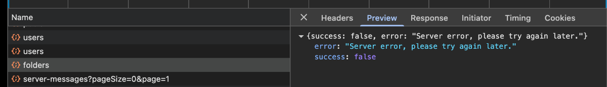

Elio Posted July 4 Posted July 4 22 hours ago, Elio said: I am also facing this issue. For what it's worth, the folders were showing up fine until I deleted a user, and then they disappeared. I can still see them in the TrueNAS admin panel, though and accessing each with the user permissions I had set up before they disappeared still works. As a follow-up, network requests are showing a server error from the API for folders
Jakor Posted July 4 Posted July 4 7 hours ago, Elio said: As a follow-up, network requests are showing a server error from the API for folders Thank you for posting this - even though I don’t personally have the skills to fix this, it helps to know something at least about what’s going on behind the scenes. there’s a dedicated thread to this elsewhere on the forum with a number of other people having the same issue - as soon as I have a chance I will link them to your post since they haven’t had any responses posted there acknowledging what might be causing the issue.
