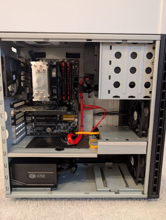

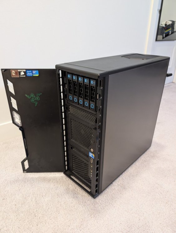

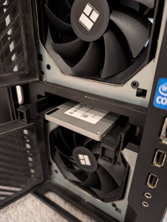

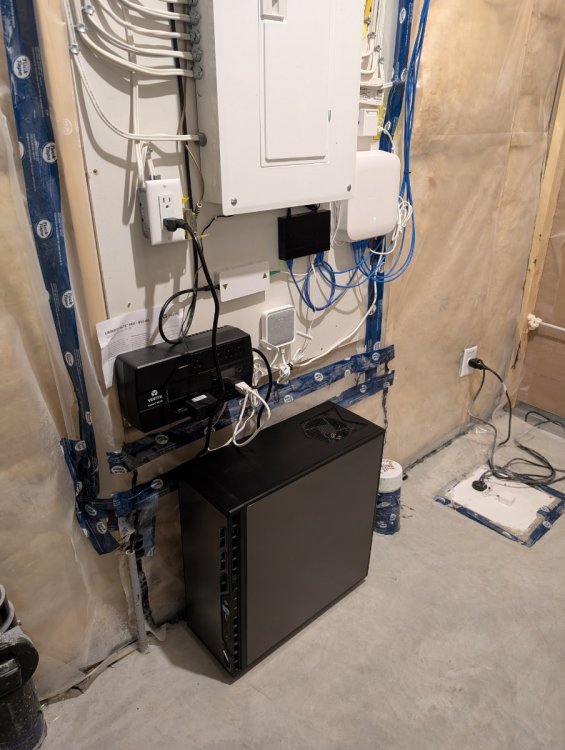

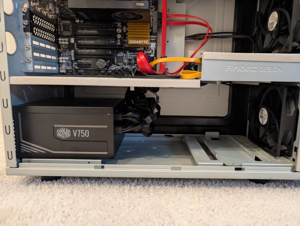

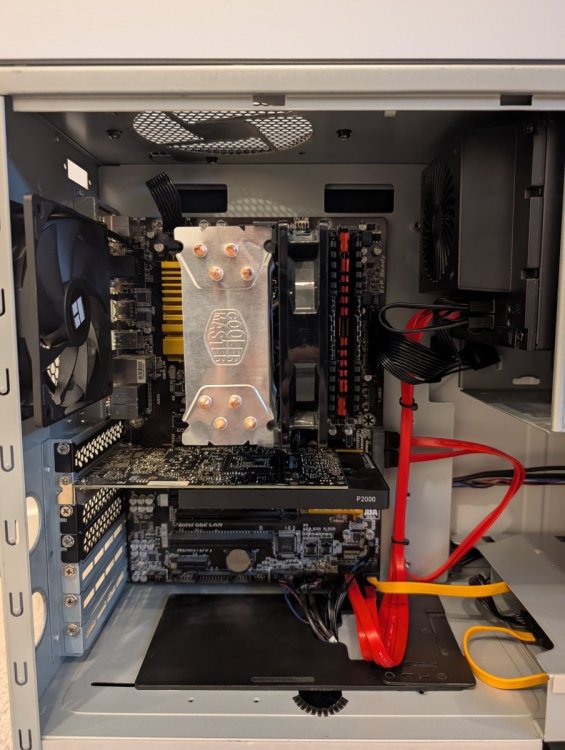

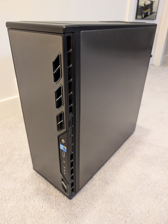

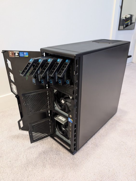

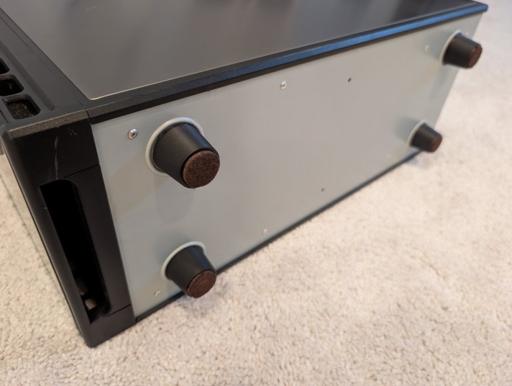

JaredG Posted February 4 Posted February 4 Here's my first ever server build. Tried to use parts either friends or I had laying around, good way to use things that were otherwise E-waste. Planning to use it primarily as a storage server, and something to get my feet wet. Will be starting with the curated apps, Immich for photo backup, and getting a decent PLEX server running hence the P2000. Also hoping to get Tailscale installed in some fashion for VPN access as well. MOBO - GIGABYTE GA-Z97-D3H (friends old used pile) CPU - Intel I7-4790K (friends old used pile) CPU Cooler - Hyper 212 Evo RAM - 32GB Samsung DDR3-1600 PC3-12800 (used but was told it was literally pulled from a junkyard computer) PSU - Cooler Master MWE 750 80+Gold GPU - Quadro P2000 (taken from the work used pile) Boot drive - Crucial M500 128gb Storage drives - 4x 2TB WD Red CMR Case - Antec P182 (OLD case from first ever gaming PC) Case fans - 3x Thermal Right TL-C12C 120mm Drive Enclosure - Rack Choice 3x5.25in 5-Drive SATA Backplane 3D Printed parts • 3.5in x 2.5in floppy bay drive sled • 5.25in Mounting Rails • Higher feet to keep things elevated in case of low standing water ever getting into my basement Future Upgrades • 2.5Gb NIC/Networking Let me know what you think! Any suggestions for improvement? Should I prioritize the network upgrade or will I even see that much of a real world difference? Quote
Jack Kennedy West Posted February 4 Posted February 4 Looks awesome to be honest. Looks great and should serve you well Quote
ubergeek Posted February 4 Posted February 4 Yeah That will defiantly work, Thats what is great about this style of setup is you dont need the best of the best to keep data safe. The only pointer I would add is to get the case elevated off the ground because it looks like its near that sump point . Quote
beardedbrewer Posted February 4 Posted February 4 That does looks great! I'm using a very similar specced system, just have less RAM. The idea of turning the 5.25 drive bays into a hot swappable 3.5 drive bay seems like something I should look into for my build. Do you have any resources for the backplane? Quote
JaredG Posted February 4 Author Posted February 4 1 hour ago, ubergeek said: Yeah That will defiantly work, Thats what is great about this style of setup is you dont need the best of the best to keep data safe. The only pointer I would add is to get the case elevated off the ground because it looks like its near that sump point . Thanks! That was the idea for printing higher feet, eventually setting up a shelf for even more seperation is probably a good idea though. I do also have a high level alarm in the sump for some more peace of mind. 23 minutes ago, beardedbrewer said: That does looks great! I'm using a very similar specced system, just have less RAM. The idea of turning the 5.25 drive bays into a hot swappable 3.5 drive bay seems like something I should look into for my build. Do you have any resources for the backplane? It definitely wasn't necessary and I could have saved some money without it, but I can't deny how legit it looks. I was originally planning on doing Two 2x5.25in 3-drive enclosures for 6-drives total, but I figured this 5-drive enclosure is good enough to get started. Here's the link. It's a bit plastic feeling but seems to get the job done. https://a.co/d/6eml2bJ Quote
Sonic Posted February 4 Posted February 4 I like your approach! Very creative!. If you at some point want to run Plex/Jellyfin you'll with the iGPU, you want a newer CPU with h265 support on the iGPU. But if not then it's fine. But you are using the Quadro P2000, so that's OK. The only thing I can think of is that this is not the most energy efficient server. But it's a pretty cheap solution, so I guess you have some money left to pay your energy bill. 🙂 Quote
