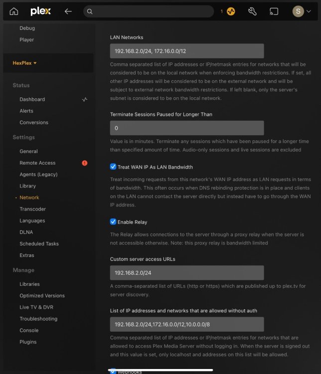

So its in the server > Network settings. You'll want to add your LAN ip address range to LAN Networks, Custom server access & List of IP Address.
This will 100% make sure you're server is being found locally.

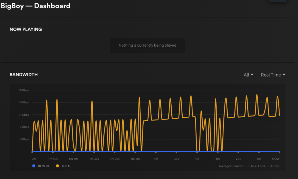

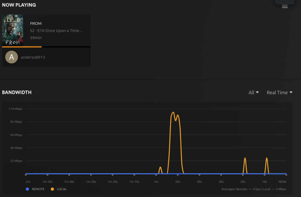

Side note, when playing content on your end device, when viewing the server dashboard now playing on a computer, what does plex show?
Take a screenshot of the player window
Will show here >>> Screenshot2025-01-26at18_34_35.thumb.png.6701e3ca68dbb502fbf61671d6ab90de.png

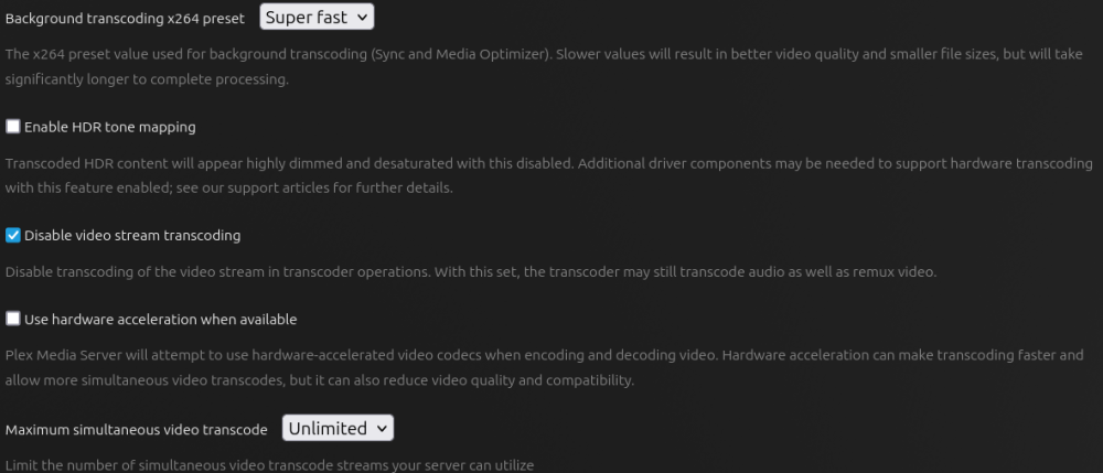

Lastly, as for your transcode settings. If you're viewing HDR content would recommend enabling tone mapping, also looks like you've got the plex pas, definitely enable Hardware acceleration as that will ensure it's using all of your hardwares recourse to avoid any issues if it 'Does' need to transcode anything.
And as for disabling transcoding, this may cause issues as audio will transcode regardless if needed, but i believe with some subtitles it may require transcoding, so fyi for the future.
If that all fails, the last thing to do is enable plex to the host network in the TN settings.

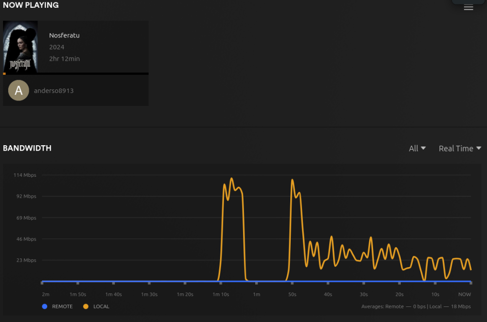

When not running anything? This:
I ran two different files; a compressed 1080p ~1GB file of a show (From) and a compressed 2160p 25GB file of a movie (Nosferatu) of which, neither glitch but both are encoded via x265.

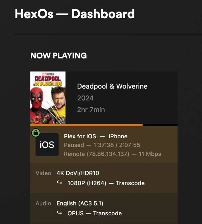

Click on those 3 lines on the right to show details and share again
Edited by Theo
Oh my damn!  Dude, thank you SO much!! Now I can really start to troubleshoot.
I really do appreciate your help @Theo - next time I see you beers are on me.

Nice, yeah looks like you’re up and running. Blame Plex, the fact the detailed view isn’t default is stupid… 🫠

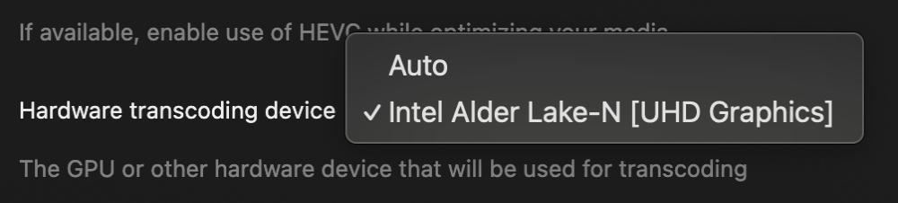

Assuming you've toggled the GPU passthrough option on the plex TN settings.
When you go into the plex transcode space, you should see your GPU listed
For context, i don't have a GPU. this is the integrated graphics on my CPU, which to my noob understanding should include the quick sync functionality. i.e no extra step is needed?

Well i'm now going to have to go down another rabbit whole... Even though my Integrated GPU is showing up, i did a test and i'm not hardware transcoding!
For context you should see (HW) at the end to connote hardware transcoding.

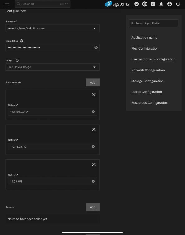

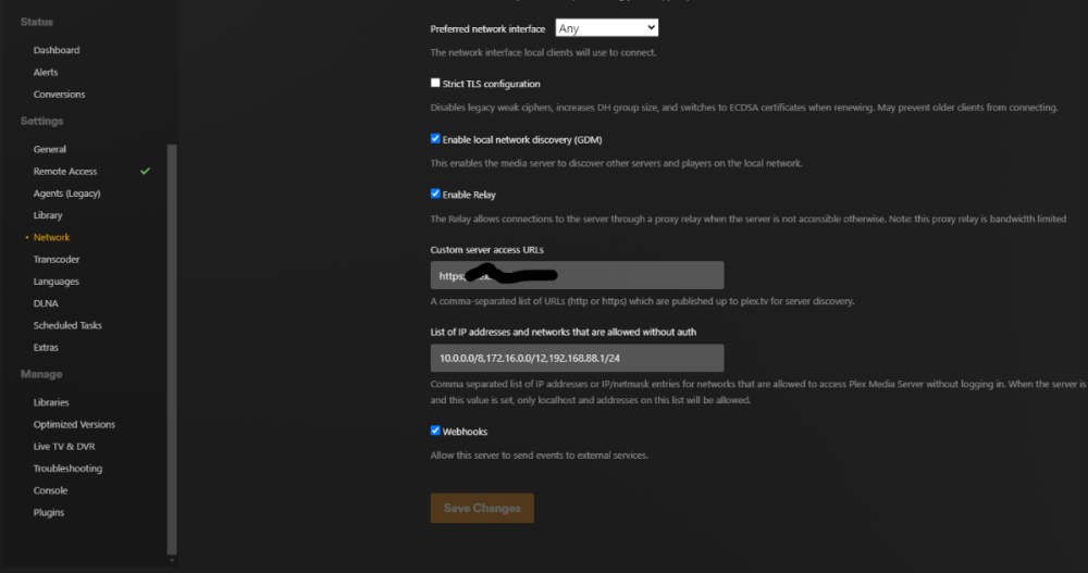

Resurrecting this because I appear to be having the same issue, but in my case I’ve made sure the local network is listed in TrueNAS settings and in the Plex settings, I’m kind of stumped here. No matter what I do it keep thinking my Apple TV is connected remotely. Also infuriating that it’s even limiting the bandwidth as I’ve got those set to maximum *and* have 2gig fiber.
Edited by backstagetaylor
I had to set the list of ip like this to get mine to work
