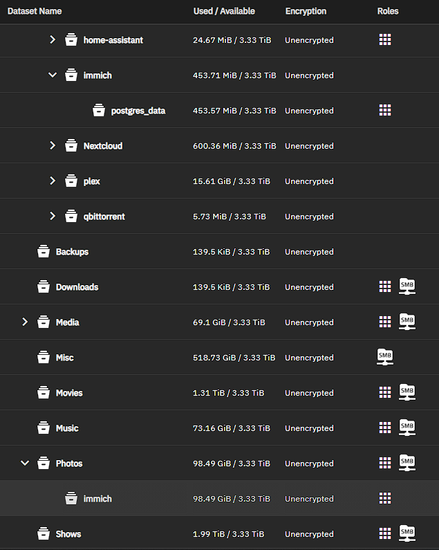

When you reinstall remember to remove the old dataset structure.  I forgot to do that and it made things more confusing for me as I did the new install.
I just tried it again as you said, but when I reinstall it, it seems to install with the same hexos structure as before.
What mine did was the post_gres in an Immich dataset under applications and the rest under the Photo dataset.  Before everything was under the Applications dataset.  So if you have this structure you have the most current version and it was expected to clear up the current issues.  Please let us know if your dataset structure looks different.
First picture is my datasets.  The second is my windows SMB share.

THAT'S IT, it had the old structure, after deleting the previous one, now it works.
THANK YOU VERY MUCH
