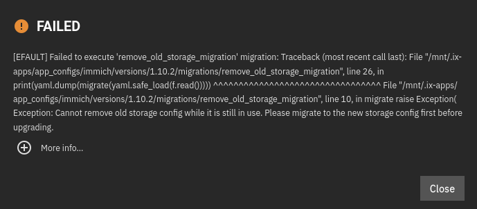

@jonp here you can see what it looks like when a user tries to update the Immich app through HexOS when they haven't manually migrated to new folders.
I am having the exact same issue since the Immich app in TrueNAS stopped supporting the old folder structure.
See the attached screenshot for the error you get in TrueNAS when attempting to upgrade the app.
When upgrading through TrueNAS it fails instantly, but HexOS is "in progress" for a very long time before giving up.
Thank you for the thoroughly detailed report!  This definitely helps. @jerod and the team and looking into this further and exploring different paths to resolve.

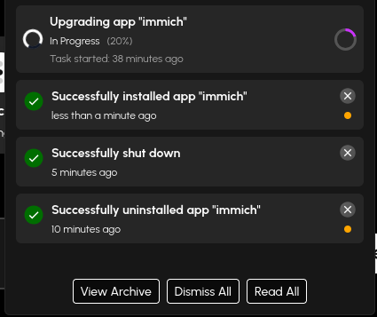

It also seems that with the latest Immich update, you cannot download the update. I have tried uninstalling it and nothing, it keeps appearing.
Go to the truenas interface, Update to 24.10.2.4 first if you haven't already. Then click on apps > discover apps > refresh catalog. Then try to update/install from the command deck again. At least this fixed it for me.
Edited by xaliax
Thank you, it is now installed but it keeps going into Deploying mode every few minutes.
I hope that the Hexos team will soon release an update to fix these issues.
Edited by Wiioscar
Reinstall should work, I had the same issue and honestly didn't want to keep fighting, so I just deleted and reinstalled. It's been working and updating fine ever since.
