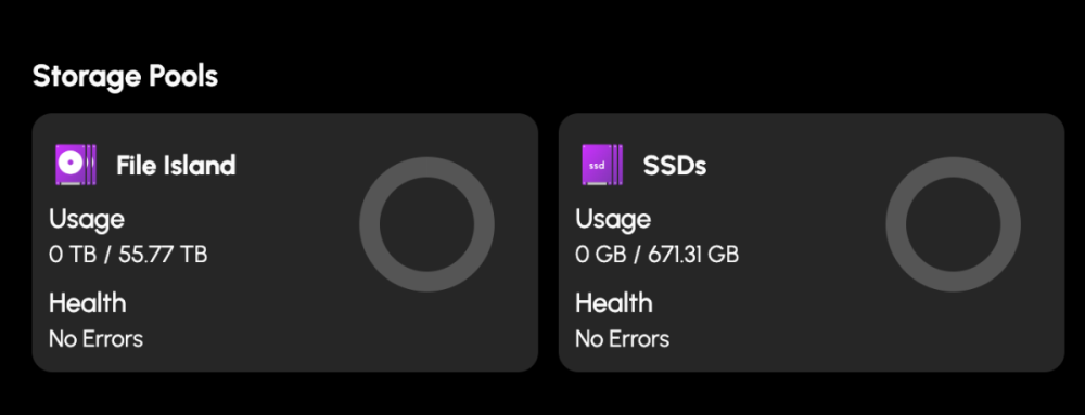

Mobius Posted May 18 Posted May 18 4 hours ago, Sonic said: This is well thought approach. One thing to keep in mind. HexOs only supports one pool at the moment. In the future it will support multiple pools. It’s still on the roadmap. are you sure? i got some new drives in today and made a 2nd pool (using hexos interface) without any issues First pool was made using truenas ui (mismatched drive sizes) so maybe making pools in truenas makes a difference? edit: maybe installing 1 click apps are broken with 2 pools? edit2: i got plex to install just not immich, weird Quote
Sonic Posted May 19 Posted May 19 12 hours ago, Sonic said: HexOs only supports one pool at the moment. In the future it will support multiple pools. It’s still on the roadmap. @Mobius, @Mindless999, my statement was not correct. You can use multiple pools. But it could be that installing 1 click apps are broken with 2 pools. If I remember correctly you have to correct this via the TrueNas interface. We had several forum post about this topic. Quote
Theo Posted May 19 Posted May 19 22 minutes ago, Sonic said: If I remember correctly you have to correct this via the TrueNas interface. We had several forum post about this topic. I personally didn’t have an issue with this on one of my servers. But if I remember that issue was a docker install issue with the initial setup. Quick resolution would be a full reinstall at the start post drive wipes 1 Quote

Mindless999 Posted 10 hours ago Author Posted 10 hours ago So, update on what's happened so far. I got everything except the HBA card, and finished building this. When The HBA card arrived, I installed it and...... no disks.... so I was a bit annoyed / surprised. After fiddling a bit around, I found out that this card only works well if you have it running in a mode with the motherboard which allows *also* legacy settings. For some reason, no matter what I did, or how I tried to firmware update it, it did not wanted to be recognised. It looked to have worked on a different system, but in the end I can't get it to work with the current system. So. Now I have ordered a new card, and will be looking forward to when this arrives. I ordered the Dell PERC HBA330 PCIe 12G HBA (0J7TNV) as a replacement, which should arrive tomorrow. To test if the disks were working, I still had an old Areca RAID card lying around, and it looks that the disks are being seen by the devices (although it also looks like the RAID controller doesn't support these sizes 🤣). So, for now: I need to wait until the package is delivered and I hopefully have a happy NAS at that moment. Once everything is finished, I will post my final build & screenshots, as well as a full (sort of) step by step on why I choose things, and how I have build it. I will update once I have an update on this! Quote
