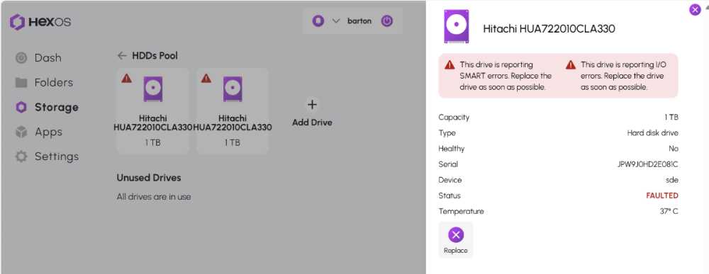

Looking at this from the HexOS side - I have a 2-disk mirror where one of the drives has failed and the other is warning (let this be a lesson that similar drives brought into service at the same time have a tendency to die around the same time...assuming they survive infant death periods).
When I click "Replace", I get this nice popup that says to "Select a replacement from one of your currently matching unused drives below...". Only I don't have any unused drives and none that match the failed one in the system, used or otherwise.  I have a perfect replacement sitting here on my desk.  What do?

Google and the Truenas admin interface for the win.

I've just had a drive report smart errors and had to shut down the machine to pull to see if it was one covered by a warranty. When I got back in after checking the drives now fully dead and the pools reported itself as unhealthy.
Problem in HexOS was the dead drive vanished completely from the UI so all I could do was expand the pool again which isn't the right thing to do.
Resolved it with a dive in to the truenas UI to see the dead drive and hit replace with the new one but the Hex UI really needs to keep the dead/removed drive in the pool so the replace button is there.
