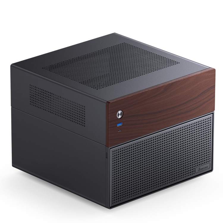

zczachor Posted August 18 Posted August 18 So, I'm thinking about this build for the HexOS NAS. Is there anything missing or wrong? Is the integrated GPU ok or do I need to have a dedicated one? Thanks! Cheers Case: JONSBO N4 Black NAS PC Case Mobo: Asus Prime B550-Plus AM4 ATX CPU: AMD Ryzen 5 5600G Cooler: be quiet! Pure Rock LP RAM: Kingston FURY Beast DDR4 3200 MHz CL16 32 GB GPU: CPU integrated OS: Kingston A400 240 GB SATA SSD M.2: 2x Kingston NV3 PCIe 4.0 NVMe 1 Tt M.2 SSD HDD: 3x Seagate IRONWOLF PRO 16 TB SATAIII PSU: be quiet! Pure Power 12 M ATX 550 W Quote
zczachor Posted August 18 Author Posted August 18 Also also, how would I set it for the easiest extendability and best operation. Quote
Mobius Posted August 18 Posted August 18 so your motherboard and poswer supply does not fit in your case. the jonsbo n4 supports up to matx cases and sfx power supplies. also we highly recommend not getting a motherboard with a realtek nic (network interface card) because those just cause problems. here is the skeleton of your build on pc part picker for reference. https://fi.pcpartpicker.com/list/pHnZTM I see that it costs ~630 euros let me see what i would do with a similar budget. https://fi.pcpartpicker.com/list/pzG73w i went with an intel cpu because they tend to do better if your usecase is say plex. with a fairly strong igpu for most non ai or gaming tasks. i went with a thermalright cooler since they are usually pretty good. this one has better cooling headroom than the be quiet one you had before. im not thrilled about the rgb personally so if you are able to find it without it i would get that. The motherboard i picked has an intel nic and ddr5 support. be careful if you decide to purchase the motherboard without using the pcpartpicker provided links as msi has like 5 different motherboards with the same name. Oh also this motherboard should fit in the jonsbo n4 no problem. 1 thing is that this motherboard only has 4 sata ports. the best way to add more is by adding an hba card (flashed to it mode) into the pcie slot. i would recommend any of the following, lsi 9200-8i, 9305-8i, 9400-8i Since the motherboard supports ddr5 ram, i picked the same capacity ddr5 ram for you. same case I didn't pick the cheapest power supply that fit. I personally like the seasonic brand of power supplies and this one was fully modular making it just a bit easier to cable manage in that case. this skeleton also came out to about ~630 euros. (not including storage) the motherboard only has 1 full sized m.2 and i opted to use it for the boot drive. and swapped out your ssds to sata ones instead for compatibility purposes. i know its not ideal but itll likely be imperceptible on the day to day. i didnt look into hdd pricing because its hard for me to check the pricing in your country outside of pcpartpicker but definitely check out the pricing of seagate exos drives since for some reason they end up being sold at a lower price than the ironwolf drives fairly often. 3 hours ago, zczachor said: Also also, how would I set it for the easiest extendability and best operation. i'm not sure what you mean by this but if you can clarify it for me i'm happy to answer this and any more questions you may have as well as help you further modify this list if you desire. 2 Quote
zczachor Posted August 18 Author Posted August 18 42 minutes ago, Mobius said: so your motherboard and poswer supply does not fit in your case. the jonsbo n4 supports up to matx cases and sfx power supplies. also we highly recommend not getting a motherboard with a realtek nic (network interface card) because those just cause problems. here is the skeleton of your build on pc part picker for reference. https://fi.pcpartpicker.com/list/pHnZTM I see that it costs ~630 euros let me see what i would do with a similar budget. https://fi.pcpartpicker.com/list/pzG73w i went with an intel cpu because they tend to do better if your usecase is say plex. with a fairly strong igpu for most non ai or gaming tasks. i went with a thermalright cooler since they are usually pretty good. this one has better cooling headroom than the be quiet one you had before. im not thrilled about the rgb personally so if you are able to find it without it i would get that. The motherboard i picked has an intel nic and ddr5 support. be careful if you decide to purchase the motherboard without using the pcpartpicker provided links as msi has like 5 different motherboards with the same name. Oh also this motherboard should fit in the jonsbo n4 no problem. 1 thing is that this motherboard only has 4 sata ports. the best way to add more is by adding an hba card (flashed to it mode) into the pcie slot. i would recommend any of the following, lsi 9200-8i, 9305-8i, 9400-8i Since the motherboard supports ddr5 ram, i picked the same capacity ddr5 ram for you. same case I didn't pick the cheapest power supply that fit. I personally like the seasonic brand of power supplies and this one was fully modular making it just a bit easier to cable manage in that case. this skeleton also came out to about ~630 euros. (not including storage) the motherboard only has 1 full sized m.2 and i opted to use it for the boot drive. and swapped out your ssds to sata ones instead for compatibility purposes. i know its not ideal but itll likely be imperceptible on the day to day. i didnt look into hdd pricing because its hard for me to check the pricing in your country outside of pcpartpicker but definitely check out the pricing of seagate exos drives since for some reason they end up being sold at a lower price than the ironwolf drives fairly often. i'm not sure what you mean by this but if you can clarify it for me i'm happy to answer this and any more questions you may have as well as help you further modify this list if you desire. Thank you for your answer. I've looked at your build and the need of purchasing SATA expansion card (or M.2 expansion card) is something I want to avoid. The reason why I have chosen to go with motherboard with 2xM.2 slots and 6x SATA ports is that I want finally use 4x HDD for storage + 1x SSD for HexOS and those 2x M.2 as a cache. Is there another motherboard that I can use that offers this? Worst case scenario is 2x M.2 and 4x SATA so I use only 3 storage drives instead of four. Motherboard price can be up to 150 euro. Did check the Seagate Exos price in my place and is around 20 euro more for 16TB than Iron wolf so no difference for me, if it's better in any way I can change it. As for settings that I want, I meant that I want to set it this way that I can swap drives without the need to rebuild the entire thing. Automate it. For example if I want to change drive because it's damaged or change them into higher capacity, everything with copy and set up itself. With redundancy of course. P.S. I have found Thermalrigh APX 120 without RGB but in grey color. I'll look for black one. Cheers. Quote
Mobius Posted August 18 Posted August 18 your best bet would be to jump up to a case that supports atx motherboards since matx motherboard with enough sata ports are rare. the jonsbo n4 can support 6 3.5" drives and 2 2.5" drives, which would require a total of 8 sata data ports to take full advantage of the case. There are motherboards that have 6 sata + 2 m.2 but they would likely be outside of your budget. any reason why you don't want to use a sata expansion card? 3 hours ago, zczachor said: Did check the Seagate Exos price in my place and is around 20 euro more for 16TB than Iron wolf so no difference for me, if it's better in any way I can change it. for a homelab i would go with which ever of the 2 are cheaper. 3 hours ago, zczachor said: As for settings that I want, I meant that I want to set it this way that I can swap drives without the need to rebuild the entire thing. Automate it. For example if I want to change drive because it's damaged or change them into higher capacity, everything with copy and set up itself. With redundancy of course. we have something similar but its not fully automated. hexos will warn you that a drive is problematic. you would then need to replace the drive and then tell hexos that the newly added drive is for the purpose of taking the place of the bad drive. then hexos will take care of the rest. 1 Quote

Mobius Posted August 18 Posted August 18 5 hours ago, zczachor said: What is the price of motherboard that supports 6x SATA? Can you give me some examples to choose from? Let me think about it. Maybe it will be worth it. I want to stay with this case. use the link i made for the build click edit this list remove the motherboard i picked then look for a new motherboard set sata 6gb slider to minimum 6. this will give you the models with 6 sata ports but majority of them do not have pricing so you will have to look for pricing yourself. also avoid any with realtek network interface cards. 6 hours ago, zczachor said: I would rather go with M.2 expansion for the two cash drives cache drives are barely a thing in hexos/truenas you are far better off allocating that budget for additional ram. 6 hours ago, zczachor said: Is there a way for two expansion cards? One with SATA and one with two M.2 drives? if you do go with expansion cards like the lsi hbas they do support both sata and nvme on one expansion card depending on the model but im not too familiar with how to connect nvme drives to them. 6 hours ago, zczachor said: If the price of those expansions cards would add to the price of the motherboard, I could pay more for the motherboard instead with all slots required. depending on the model the expansion cards are not expensive and might be a lot less expensive than different motherboard. 6 hours ago, zczachor said: What if I want to add more drives to my NAS later. Will I have to rebuild the RAID or is it as simple ass clicking add new drive to the pool? if you start with a pool of at least 3 drives it is as simple as clicking add new drive and waiting. 5 hours ago, zczachor said: Or what if I want to change old drive in Nas and replace it with a new one with higher capacity? at this time until you change out all the drives in a pool all drives will be treated as the same size as the lowest capacity drive. once you finish changing them out, it should automatically increase in capacity. in the distant future we will have a feature called zfs anyraid which will let you mismatch drive sizes and still have use of the full capacity. That said its likely years away and may not be compatible with existing pools. 1 Quote

zczachor Posted August 19 Author Posted August 19 10 minutes ago, Mobius said: this looks not bad to me. since it comes with 2 sata break out cables each worth around ~10-12 usd Alright then. It also says that it has IT mode P20 Firmware already. I will go with your build and this extension card then. One last question, I think. I have checked the case details, and it says that the tallest CPU cooler is 70mm. I have then looked at this 65mm Noctua: Noctua NH-L9x65 chromax.black 33.84 CFM CPU Cooler (NH-L9x65 chromax.black) - PCPartPicker There is only 5mm of spare room. Would this not choke the cooler if I go with it? Or should I go instead with Noctua NH-L9i-17xx chromax.black 33.84 CFM CPU Cooler (NH-L9i-17xx chromax.black) - PCPartPicker that is 37mm OR this black Thermalright Thermalright AXP90-X47 42.58 CFM CPU Cooler (AXP90-X47 BLACK) - PCPartPicker 47mm tall? Quote
Mobius Posted August 19 Posted August 19 the jonsbo n4 case has ventilation holes all along the top of the case the 70mm coolers wouldn't really be chocked and would likely be bringing in fresh air from outside of the case Quote 1 Quote
zczachor Posted August 19 Author Posted August 19 3 minutes ago, Mobius said: the jonsbo n4 case has ventilation holes all along the top of the case the 70mm coolers wouldn't really be chocked and would likely be bringing in fresh air from outside of the case OK. Thanks for your help. I think I have all my questions answered. I will make a new post if I have any questions about setting up the HexOS. Cheers! Quote
zczachor Posted August 20 Author Posted August 20 On 8/19/2025 at 4:35 AM, Mobius said: glad i could help Hi. I have one more question. The case only have half size expansion cards slots on the back. Not full size. Should I look for another one? Cheers. Quote
