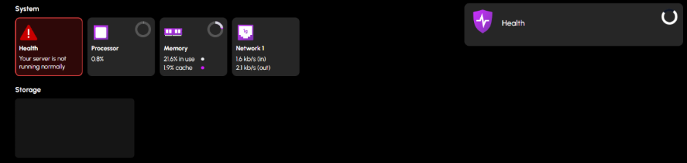

defan24 Posted Sunday at 03:58 AM Author Posted Sunday at 03:58 AM Janky Storage solution - 2x USB Flash Drives, here goes nothing It lets me create a pool...and it works.... Now the system Health is saying that something isn't running normally (Shocker) Now the storage pool wants to show, but acting like it isn't. Weird Bug Rebooting... No Dice. System still showing issue with Health, but no details. See Attached Image Quote

rymn Posted Sunday at 03:27 PM Posted Sunday at 03:27 PM 11 hours ago, defan24 said: Janky Storage solution - 2x USB Flash Drives, here goes nothing It lets me create a pool...and it works.... Now the system Health is saying that something isn't running normally (Shocker) Now the storage pool wants to show, but acting like it isn't. Weird Bug Rebooting... No Dice. System still showing issue with Health, but no details. See Attached Image thumb drive array is a hilarious edge case! makes me want to do something dumb with sd cards Quote
The_Green_Nerd2 Posted Sunday at 04:36 PM Posted Sunday at 04:36 PM 12 hours ago, defan24 said: Janky Storage solution - 2x USB Flash Drives, here goes nothing It lets me create a pool...and it works.... Now the system Health is saying that something isn't running normally (Shocker) Now the storage pool wants to show, but acting like it isn't. Weird Bug Rebooting... No Dice. System still showing issue with Health, but no details. See Attached Image Lmfao, if it works it works 1 Quote
defan24 Posted Sunday at 09:11 PM Author Posted Sunday at 09:11 PM 5 hours ago, rymn said: thumb drive array is a hilarious edge case! makes me want to do something dumb with sd cards To be fair, it is working now, and the SD Cards was actually what I was looking for, but I couldn't find the USB adapters for them Quote
