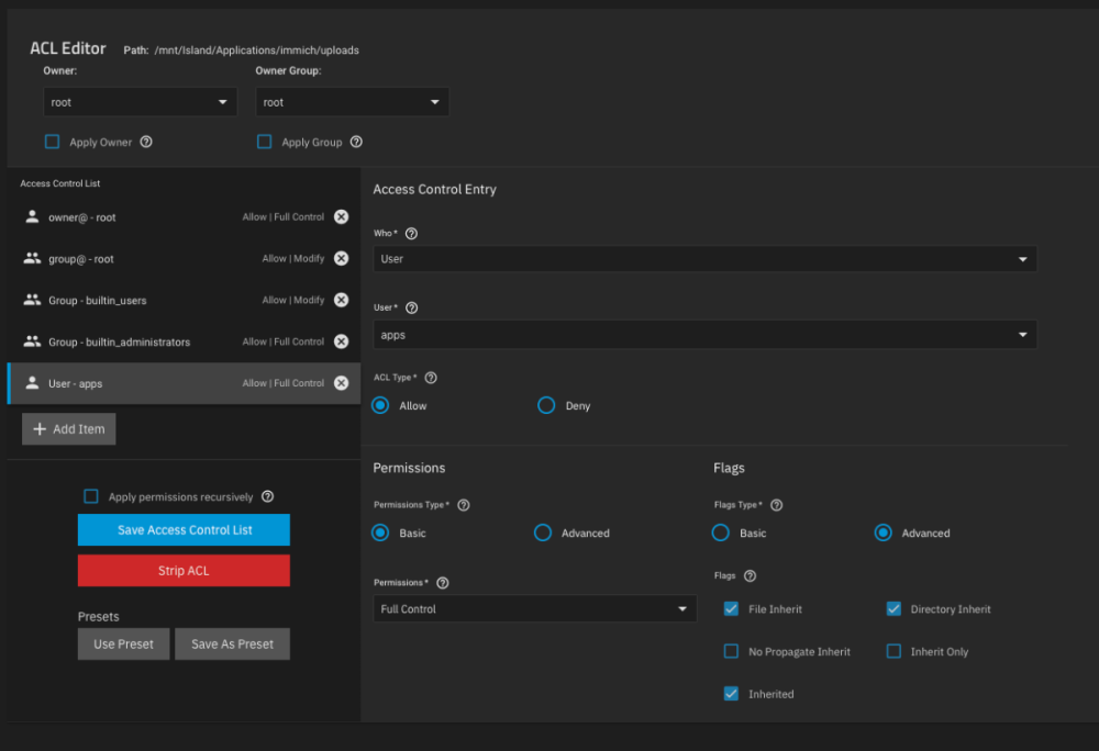

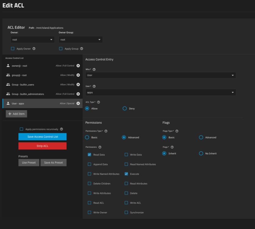

Asked ChatGPT and it mentioned giving all the immich folders ACL access to the "apps" user like this and it has worked. Is there a misconfiguration in the curated app?
CleanShot2025-06-12at09_29_21.thumb.png.854fb5c81daa40477bc71c9cbb34f956.pngCleanShot2025-06-12at09_29_05.thumb.png.5076564c8909e99ff08720d4de155ca8.png
